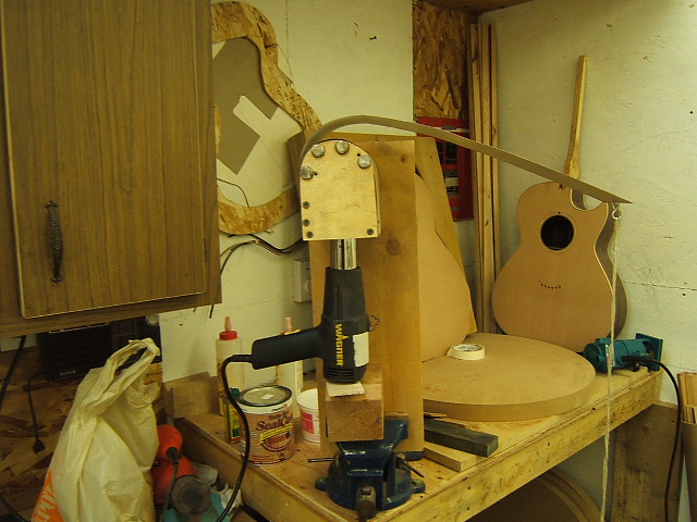

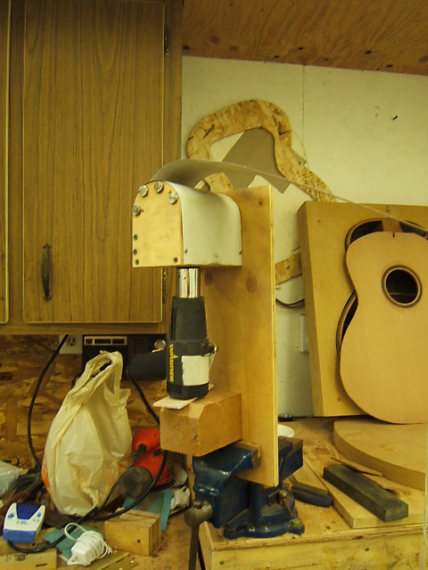

Also, I bend the entire side before I cut the cutaway part off, than bent it backwards in my cutaway bender.
This will help too I think.
Here is the bender.
As you can see I use a heat gun for the heat source, this thing works great, do the binding at the same time.

Rod,
Whats the white material on the bender?
-j.

J, the white is just aluminum flashing I used for the slats.
